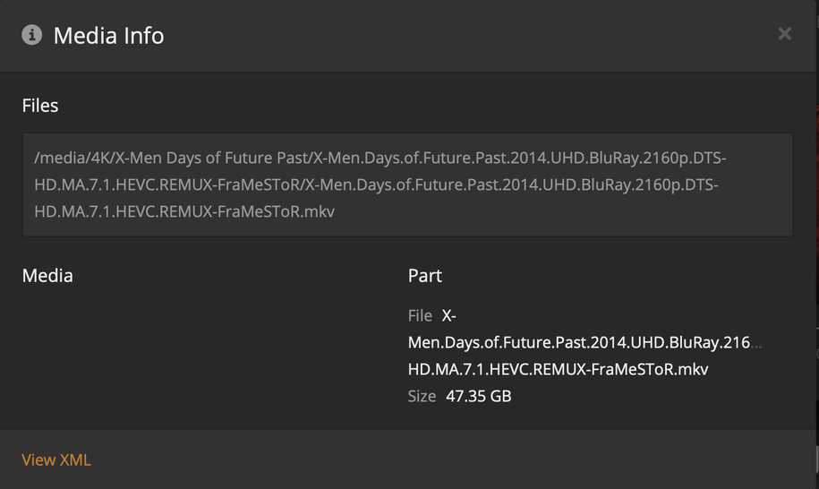

Hi @ChuckPa I’m hoping you can help out. I’m really at a loss here. I’ve reinstalled the Plex server software and rescanned and rebuilt the library, and I’m still running into errors. Nothing will play, locally or remotely (remote access is enabled).
When I run into a movie that the server couldn’t analyze, it shows this info in the “Get Info” screen (ie. nothing but the filename, no video media statistics)
I then notice that the Media Scanner Analysis log file shows “resource temporarily unavailable” when attempting to get that info.

When I attempt to play the file, the error that comes up is the same as the one in the first post. s1001

I’ve had files that looked exactly like your Media Info screen shot
They were corrupt files and it wasn’t a Plex issue. They wouldn’t play in other players like VLC either
All the files I’ve been looking at as part of this process play in VLC just fine. The movies are a bit stuttery, but only because the bandwidth is rather high for VLC and my laptop, but they play.
In addition to this, I’ve just installed Plex on my laptop, added the same folder as a library, and all the files I’ve been using as examples match, analyze, and play just fine
