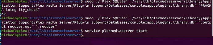

I did find some corrupt errors in the logs when I looked at them manually. I tried running the tool and got this:
sudo ./‘Plex SQLite’ /var/lib/plexmediaserver/Library/Application Support/Plex Media Server/ “PRAGMA integrity_check”
Error: near “Support”: syntax error
So I am assuming I need to run a repair?

/usr/lib/plexmediaserver$ sudo ./‘Plex SQLite’ ‘/var/lib/plexmediaserver/Library/Application Support/Plex Media Server/’ “PRAGMA integrity_check”
Error: unable to open database “/var/lib/plexmediaserver/Library/Application Support/Plex Media Server/”: unable to open database file
I am in the same dir as Plex SQLite. (I escaped the logs dir). Here is a screenshot of my logs location (I don’t see anything that looks like a db?).
The location is per Where is the Plex Media Server data directory located? | Plex Support
Ok I figured out where the database is. This link probably needs to be updated Where is the Plex Media Server data directory located? | Plex Support
The check came back ok. I then tried the repair option per Repair a Corrupted Database | Plex Support
