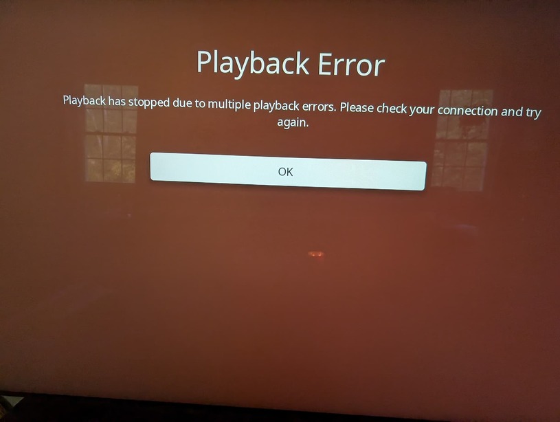

Playback error Plex Transcoder signal: Arithmetic exception 1.41.7.9795
Server Version#: 1.41.7.9795-b8182f5e6
Player Version#: Roku 7.36.14.10147-6754caeec-Plex
After upgrading to beta version 1.41.7.9795 from 1.41.6.9685 I started seeing a Playback Error. Looking into the logs I found an SIGFPE arithmetic exception failure in the transcoder. Installing 1.41.6.9685 again fixes the bug.
May 17, 2025 12:18:02.079 [140386662062904] DEBUG - Jobs: '/usr/lib/plexmediaserver/Plex Transcoder' exit code for process 567358 is -8 (signal: Arithmetic   exception)
May 17, 2025 12:18:02.079 [140386186394424] DEBUG - Killing job.
May 17, 2025 12:18:02.079 [140386226633528] DEBUG - Streaming Resource: Terminated session 0x7fae501cb998:62bb83c906da824267c07ba64c89554e with reason        Conversion failed. The transcoder exited due to an error.
May 17, 2025 12:18:02.080 [140386186394424] DEBUG - Signalling job ID 567358 with 9
May 17, 2025 12:18:02.080 [140386186394424] DEBUG - Job was already killed, not killing again.
Direct stream H.264 video, TRUEHD 5.1->EAC3 Audio Transcode

Thanks.
Plex uses MUSL so, as you found out, gdb is limited success …
but the stack trace is GREAT
I just repro’d the error as well in a container running to a file.
NOW,
The $500 question.
Is it only this file or is it ALL files ?
We had a LOT of EAC3 testing and confirmation. This is the first reported failure.
