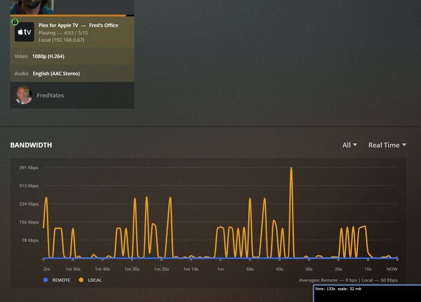

It happened again, while playing an MP4 movie, and I managed to catch it in the process. Attached are screen shots, the log file and the xml data.
It played the movie “Argo” for 2 hours without any problem and then I selected “Behind The Scenes”, a 5 minute documentary at the end of the movie and it started buffering, pausing, whatever. I repeated the scenario today, same conditions. Normally I am in the house using a WiFi repeater which is about 50’ away and 4 walls between. That is where it happens most often.
Does this help you “see” the problem better? Thanks, Fred
This is with the PMS computer connected to the modem via cat5 and the modem 15’ from the Apple TV with direct line of sight.
Notice the extremely low bandwidth being used and it is still buffering.
This is during the movie.
