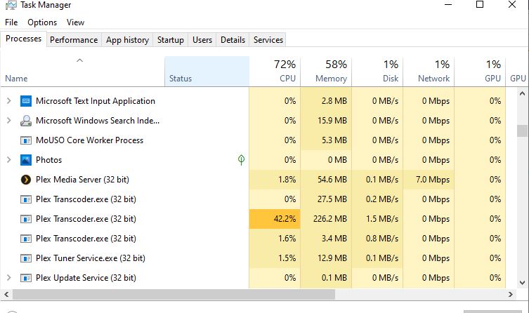

If I look at Task Manager during a recording or playback session I see Plex Transcoder running.
Even without HW transcoding this NUC should be able to handle one live stream without issue.

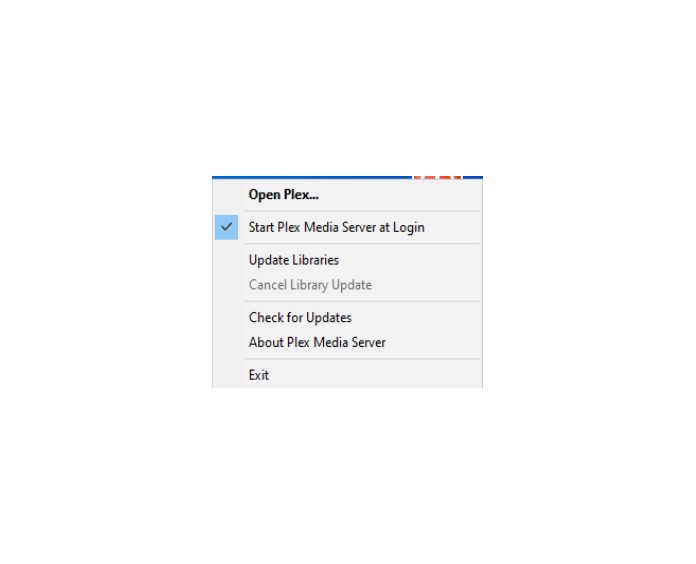

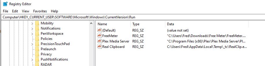

How are you accomplishing this. Through autologin or running Plex as a service?

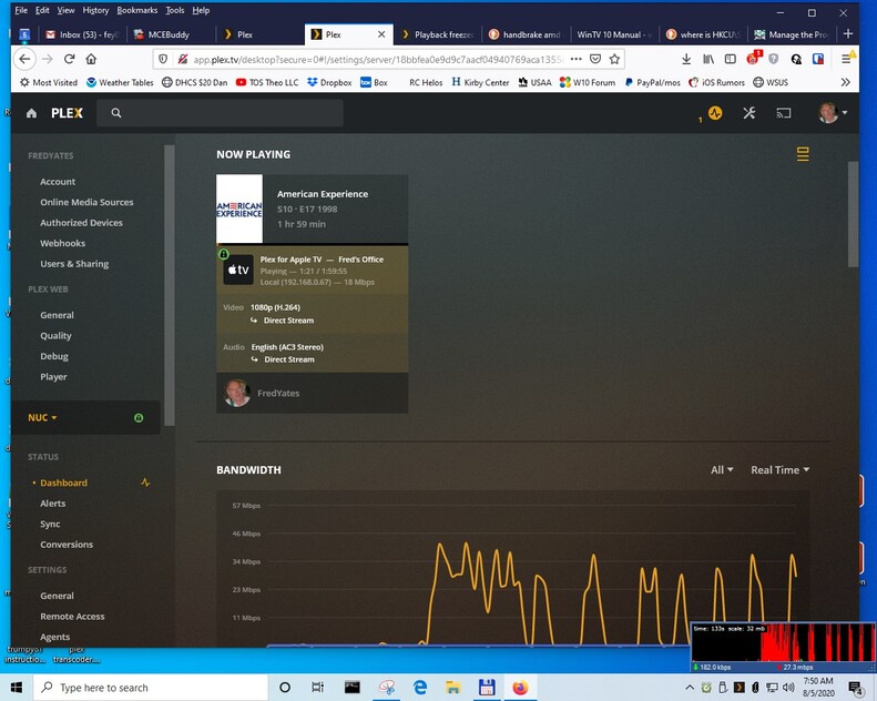

Please post a Dashboard screenshot of Live TV playback.
It is set to 3Mbps because that is our max download speed
If all the devices are local to the Plex server, there should be no need to force a lower bandwidth.
I didn’t do anything, that is how Plex installed its self.
From the plex icon in the system tray
From the registry:
Dashboard:

Can you do a dashboard screenshot while trying live tv and if possible while it is freezing.
