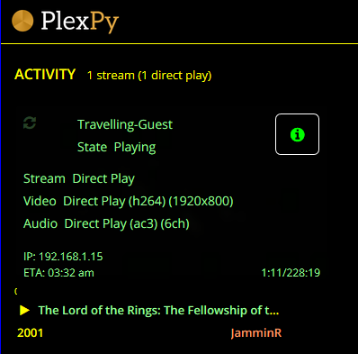

Here’s my Roku 2 XS “Direct playing” a 1080p x264 MKV with an AAC and a AC3 track.
Most of my MKVs are 720p x264 level 4.1 at 6-8mbps.
