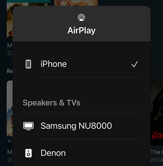

The 660 has Airplay so you should be able to cast to it from the Plex iOS/android app (Airplay piggybacks on wifi so bluetooth not needed).
Ensure DLNA is on in the Plex server as it may be simpler to use DLNA as opposed to Airplay.
I could be wrong with your setup but it works for me and our Denon (X1500H).

I can Airplay to my Denon from the Plex app (iOS)
Oh I missed that. Thanks
