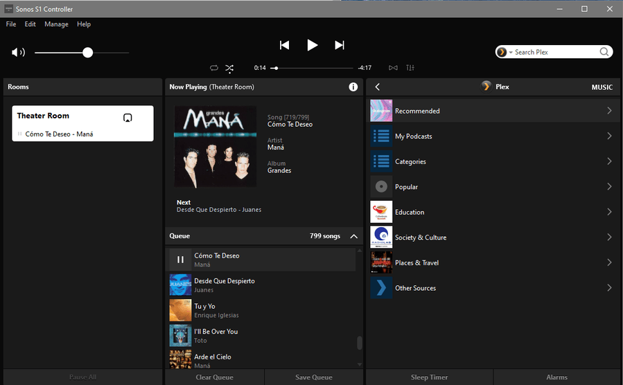

SImilar Problem.
Had been accessing plex for a while via sonos (although it did lose connection every now and then.
Tonight i lost all access to plex from sonos. Plex is remote from where I currently am.
