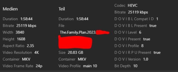

Ok can you also check which profile version of DoVi the file is? You can find the info by going to the web app for your server navigate to the preplay screen of an affected title click the ... then Get Info the information will look like this… (if you could share a screenshot that would be great otherwise I need the profile and level)
Sure, for example this:
Unbenannt
Is this enough info or do you still need a sample file?
