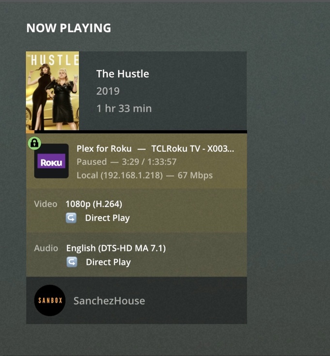

Whenever you play a file with DTS audio, direct play is happening, but only if you’re watching the file without stopping, rewinding or fast forward the file. When this happens, audio stops and you hear no sound, but the server is claiming that direct play is happening. I do not experience this with Plex for Android so it is definitely an issue with RokuOS and its app for Plex.

Feedback would be great. If you need any other pictures, specs, or logs from my end, I will provide them, thank you.
