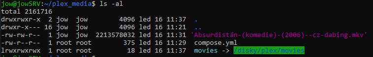

When I want add library in webui, it doesnt see directory. I followed this steps, so my mounted disk is /disks/hdd/ but I cant even see /disks/ (screenshot)
here is my “ls -al /disks”
obrazek

Yea, and this changes nothing… I even tried symlink.
obrazek
Absurdistan is one movie for test, this one works, but still cant access to mounted drive. Even when I am owner of folder.
obrazek
In your compose file you have /disks/hdd/movies mapped to /tv. In your first screenshot, you can see the /tv directory in the left column, and I assume if you scroll down it will also be in the right column.
The left side of the volume map is the path on the host, the right side is where you will find it inside your container. You can make them the same, or they can be different paths as you have done in your compose file.
