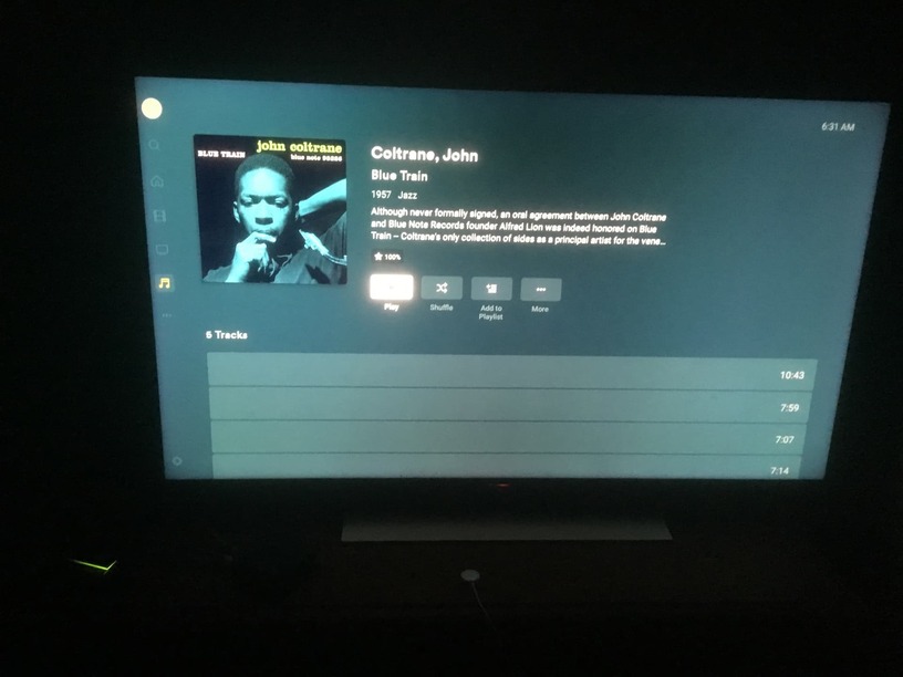

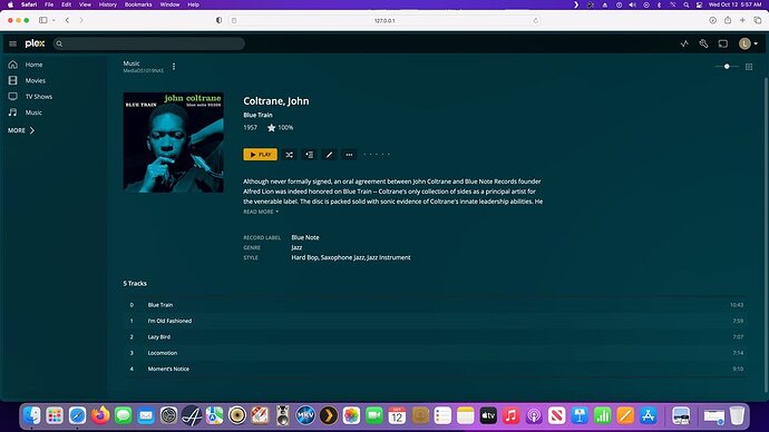

Here’s the bad news. Most of the problems I described previously remain. Some albums have my metadata. Others do not. On some albums, the tracks are blank when displayed on my TV. Fortunately, those blank tracks generally play music. On some albums, the artist’s name appears as the name of the track, at least on the TV. If this weren’t confusing enough, the Plex screens on my TV and computer are different even though both Plex apps are looking at the music files on my NAS, which is running the operative PMS. For example, when the tracks are blank on the TV, they sometimes have song titles on the computer. However, the song numbers generally begin with 0 rather than 1.

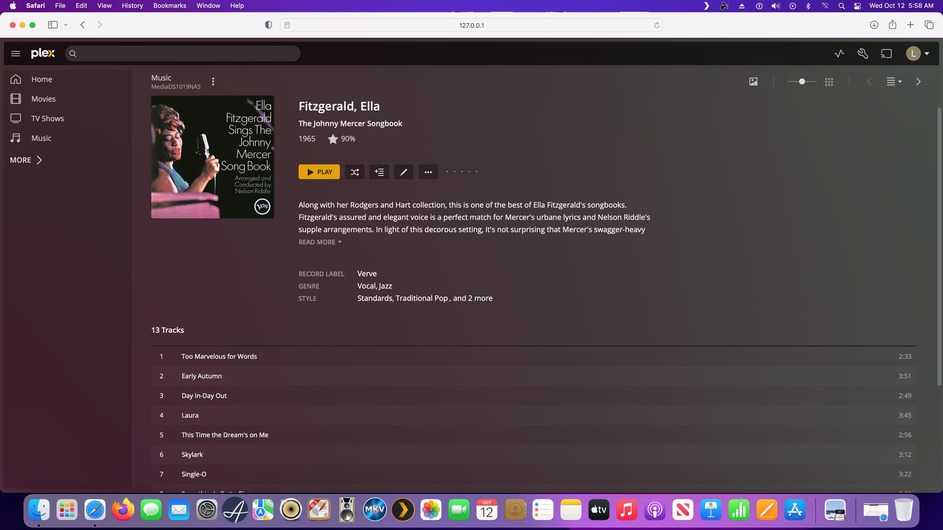

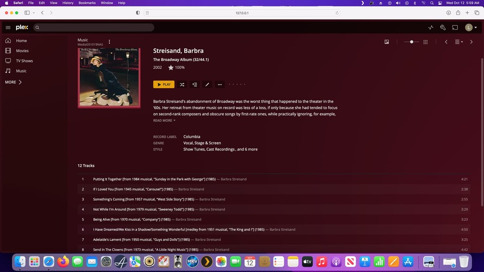

Here are some screenshots from my Mac mini:
The tracks are blank on the TV.
Plex removed the metadata I added to the following album.
Plex did not remove the metadata I added to the following album.

Yes, by “metadata,” I am referring to the extra information I added to the various tracks and/or to the album title. I think your observation of my versus ( ) is incorrect. Please look closely at the song information in my library folders for the third and fourth albums and then look at Plex’s handling of that song information. All of the information I added to the Ella Fitzgerald album is gone, but all of the information I added to the Barbra Streisand album remains. In both cases, I used for the source of the song or other information and used ( ) for the recording date or release date.

I wasn’t really looking at the track information (hence my question about sample size/rate at the album level). Now that you’ve pointed it out though, I don’t have any insight to offer as to why it would handle the tracks differently. Though you do have different information in parentheses for the albums (just the year for Streisand and a recording date for Fitzgerald).

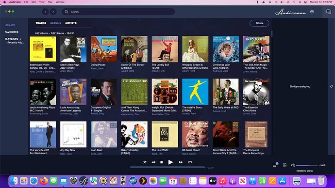

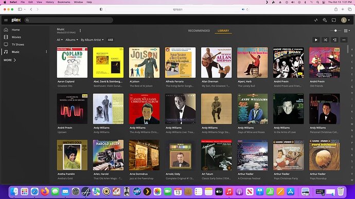

Hi. I should have omitted the aside about the Bill Evans Trio because it really isn’t relevant.
Here are some screenshots that might explain the album-ordering problem better than I did. All three screenshots show the first entries in my library.
Apple Music:
Audirvana:
Plex:
