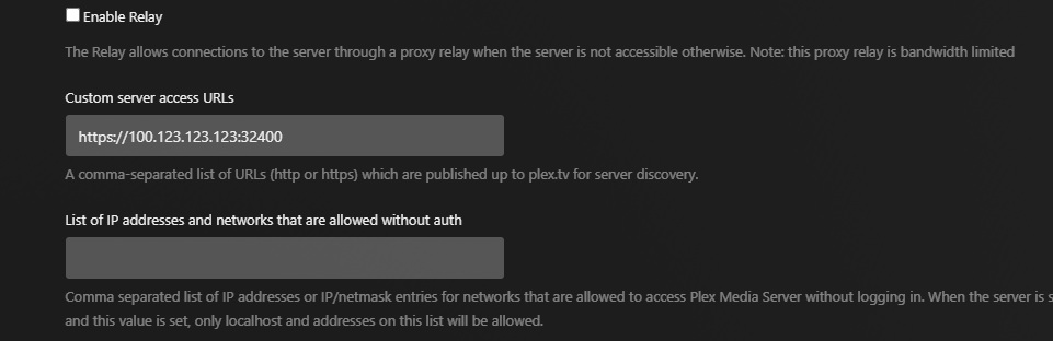

Ah ok, after adding my server’s Tailscale IP address to “Custom server access url” in Plex Network settings, it now works. (It still seems like the Manual Connections isn’t working at all though, unless its purpose is not what I would expect.)
Example:
https://100.123.123.123:32400
