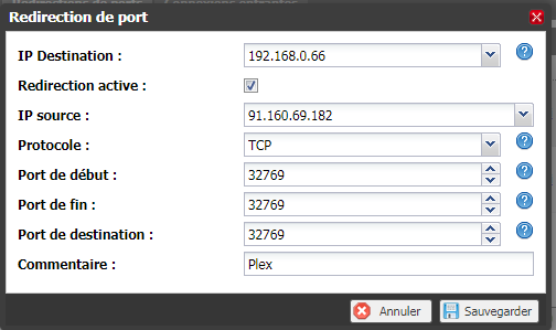

The Mac does have a static IP, in the 0 subnet and I have put 32769 as the port for both udp and tcp. Here is a screenshot of the setting:
Obviously, it’s in French but it should be okay.
IP destination is the Mac’s static IP
IP Source I put the outward facing IP address for the system as reported in Plex?
I hope that’s right. The only other choice in the IP Source field is “Toutes”, which means all.

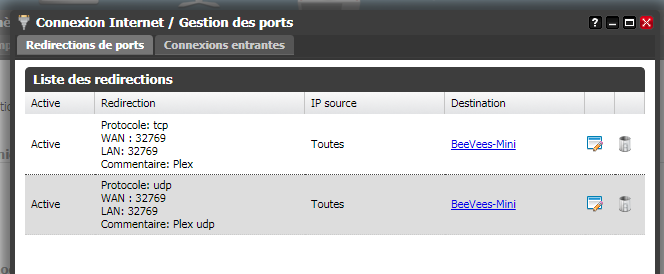

Okay, been back to the router settings and although I had set a static IP on the Mac, I hadn’t set one up on the router. That is now done and Plex at least now sees:
Private 192.168.0.39 : 32400 Public 91.160.69.182 : 32769 x Internet
on the right subnet, but still not available outside the network.

I set the source IP to all and the port to 32769
The worst thing is I have to use their sodding router… :frowning:
B
But I don’t think I can change that private number? The incoming one is changed to the right thing 32769. I’ve tried it on and off again so many times I think I’m in an episode of the IT Crowd :smiley:

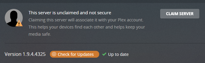

And another thing. I keep losing ownership of the server. That’s to say, it shows this message:
B
How do I step back a version or two?
B
