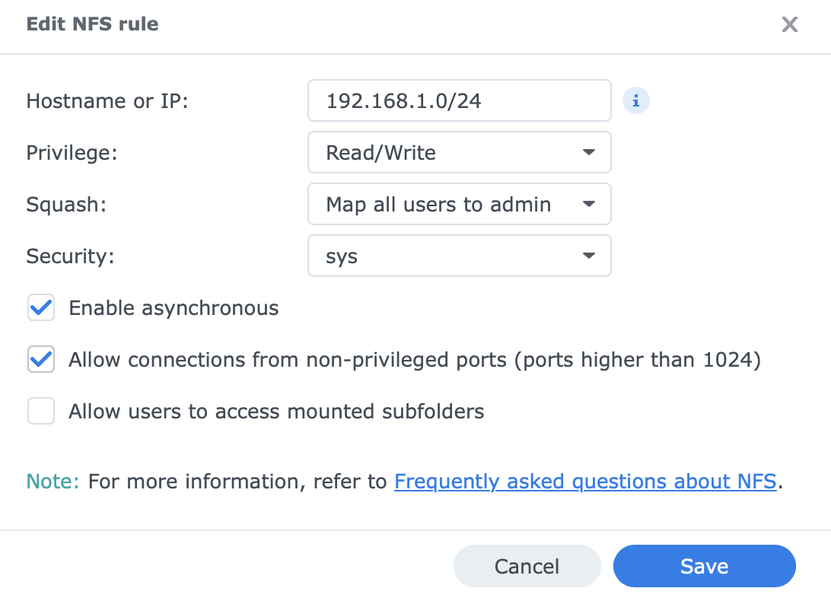

NFS for me is working fine, and it is faster than SMB. I want to share my config, I am using the AutoMounter app.
My /etc/nfs.conf config file:
# nfs.conf: the NFS configuration file
nfs.client.allow_async = 1
nfs.client.mount.options = nolockd,async,bg,noowners,noatime,soft,intr,rwsize=32768,timeo=900,retrans=3,proto=tcp,nfc
In my case, I do not mount the NFS shares on /Volumes, I mount then on /Users/myHomeDir/NAS directory. I am using the AutoMounter app.
On the Synology, I have the following configuration under file services:
Advanced settings:
Shared folder NFS permissions:
With this configuration it works great, without any issues.
