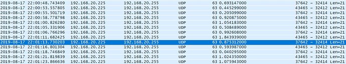

5 years later, seeing the same behavior on
11.2-RELEASE FreeBSD 11.2-RELEASE #0 r335510: Fri Jun 22 04:32:14 UTC 2018
with
plexmediaserver-1.16.4.1469 Plex Media Server component
plexmediaserver-plexpass-1.16.5.1488 Plex Media Server component
Enable local network discovery (GDM) - Is Disabled
This enables the media server to discover other servers and players on the local network.
I am seeing exactly the same issue except it is broadcasting UPD to 1.0.0.0 twice every 5 seconds on two servers.
This is an external network so do not want to see this behaviour and it is filling my firewall logs.
