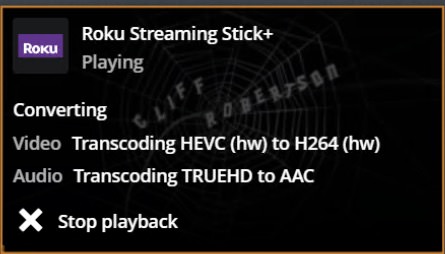

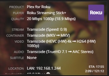

It says (hw) on the in and the out when it tried to do the transcode.

It looks like HW is in play for encode/decode. I doubt a dummy plug will change anything.
The dummy plug didn’t come in yet, but I did plug in a 4k monitor.
It hovers around 11% with a 4k to 1080p stream going but gives up after a lot of buffering.
