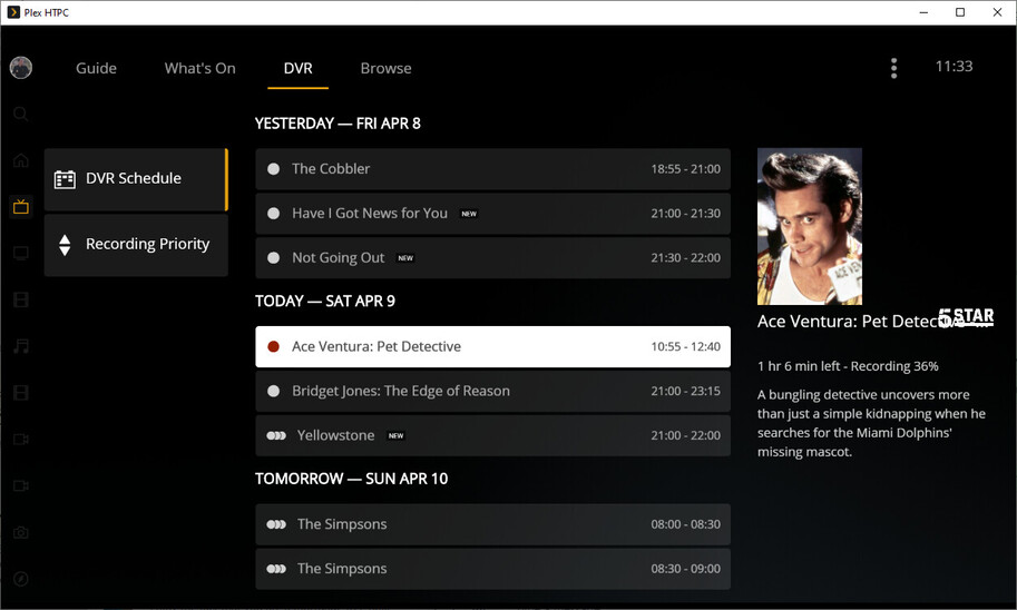

Whilst I love the new DVR section of Live TV & DVR and it was a welcome return (especially after waiting so long for it in the Tizen and Xbox apps) but I have noticed a few quirks /rendering issues over the last few weeks that I thought I would mention in case the development team wasn’t aware of them:
  1. Long TV programme or movie names overwrite/are overwritten by the channel logo - perhaps the logo would be best located under the title or next to the movie/show image and an ellipse could be added to a truncated title.
  2. Current recordings don’t show the start time and channel text (such as 032 5 Star).
  3. Past recordings loose all details that was shown from the guide, apart from the title (in the case of a movie) or episode number and name (in the case of a show).
The following screenshot highlights issues 1 and 2 with Ace Venture: Pet Detective currently recording:
Also, and I appreciate this is subjective but, the DVR Schdule and Recording Priority buttons seem a bit large (height wise) compared to others in the app, such as the Side Bar, Top Bar and TV Guide buttons.
