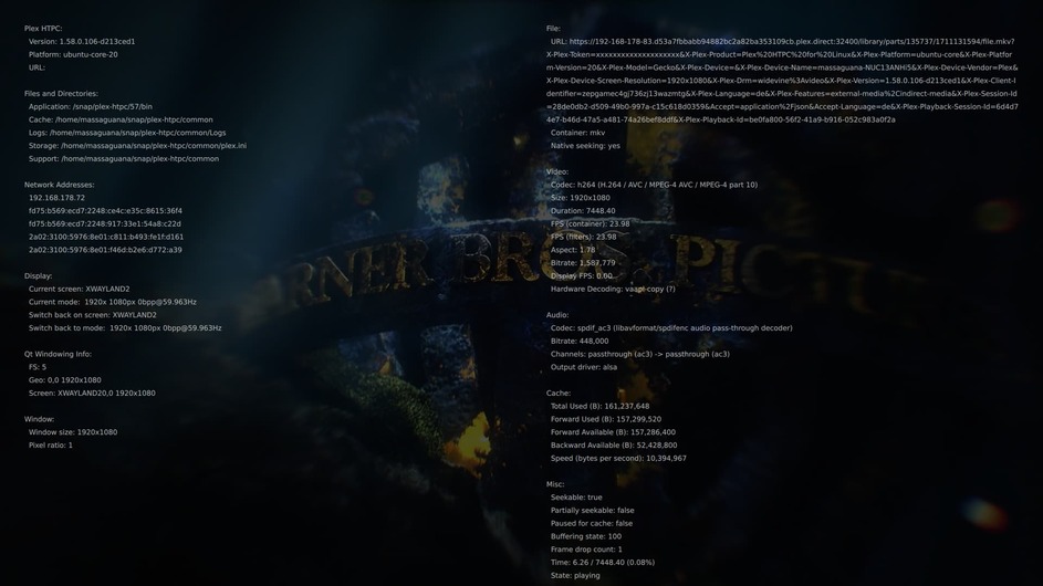

Your system is using software OpenGL:

This is going to severely restrict your rendering options available and you can see from the above that MPV failed to find one that can work. The way that UI and video are stitched together requires rendering through OpenGL.
You really need hardware OpenGL available to the app if you want anything in terms of performance.
