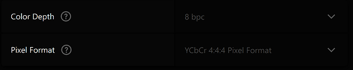

What AMD video settings do you use for the LG (RGB 8 bit full etc)

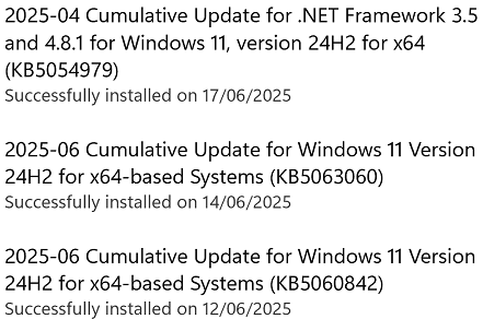

These are the Windows Updates I have installed this month.
IIRC I did install a Windows update around the same time I started experiencing this issue so I tried uninstalling the last few Windows Updates updates, rebooted the machine, but this failed to resolve the issue.

Are you using HDMI 2.0b or HDMI 2.1 ?
I was unable to get Plex HTPC to run with YCbCr 4:4:4 but that is with a Denon in the chain that uses HDMI 2.0b (even with HDMI passthrough on). Video would fall over especially with HDR/subs/4k. Lost signal, video flashes, corruption. Audio would play but no video. I run RGB full 8 bit with all processing off in the Denon and new HDMI cables (HDMI 2.0b certified).
If you are pushing content through HDMI 2.0b, things can fall apart easily with high bitrate material with subs etc, especially with 4:4:4.

Try RGB 8 bit and the TV will dither to effective 10 bit. I also use RGB as better for desktop use and less bandwidth need versus 4:4:4.
4:4:4 is pointless with media as most of it is 4:2:2. 4:4:4 is needed for gaming (and maybe desktop use) but you need to run HDMI 2.1 gear.
