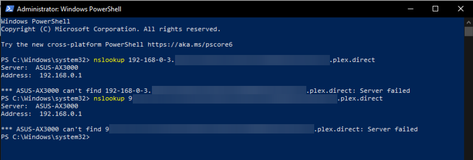

I did the nslookup on both local and remote IP:

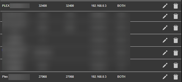

Here’s how my port forwarding on router looks like:
So, I am not sure if there’s anything you can read out from the exercise I did, but I would welcome any suggestion.

Front what I can see it looks like you have DNS rebinding protection enabled on your router.
This is indicated by two things. Firstly the response from the Plex API query returns dnsRebindingProtection="1" which indicates Plex detects that this is likely the case. It also appears to be listing the local IP for your server so devices should be finding it otherwise.
Secondly the plex.direct local hostname for your PMS is not resolving.
If you use the command nslookup 192-168-0-3.your32digithexcode.plex.direct 8.8.8.8 then hopefully it should return 192.168.0.3. Adding 8.8.8.8 to the end of the command tells nslookup to use the Google DNS server rather than your router. This would confirm that it’s likely DNS rebinding that’s causing the issue.

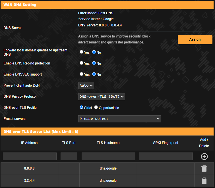

DNS Rebinding has always been off on my router, it was one of the first things I checked:
While checking rebinding, I realized that a router where my Plex server is connected to has fallen out of ASUS AiMesh. Anyway, I readded the router to the mesh, however, that did not help solve the issue.

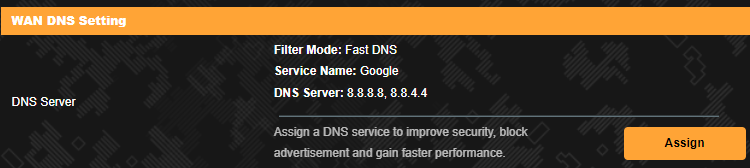

So, the final solution was to assign Google DNS servers to my main router and voila, everything works as it should. I mean WTF? I had this internet provider for two years, had no issue, and all of a sudden their DNS servers began to cause an issue with Plex? I don’t get it.

I have enabled DNS Privacy Control on the router, everything still works fine:
As for enabling DNS Rebind Protection, I am unable to find the exception list when DNS Rebind Protection is turned on, so I will keep it off until I find a way to create an exception for any URLs I wish to add to the exception list. Had a quick look at Google but was unable to find where this exception list is located.
