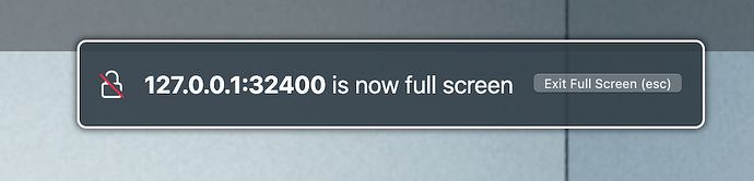

So, while working, I noticed that the window Plex played in has a completely different IP address. One I’ve never seen before.
Does this matter?
127.0.0.1 is the customary loop-back address, and generally used for communications completely inside/within the host. For all intents and purposes, this address is available on all IPv4 connected hosts. Edit: while PMS will listen on this address/interface (lo0 in my world,) nothing outside this host will be able to connect to it.

Thats local loopback IP address.
