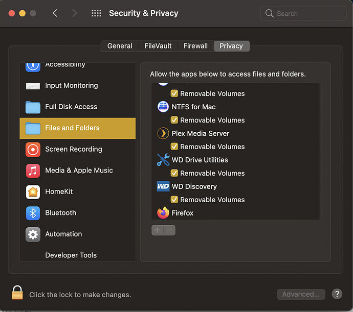

Maybe - have a look here:
@SE56 may know a trick or two…
Yes I do, he needs to give it permission to the External Volumes

I’m running macOS Mojave, where Files and Folders isn’t an option in Security & Privacy. Plex has no issues seeing the harddrive and its content, it’s just that it keeps spinning up and down when playing and browsing the library.

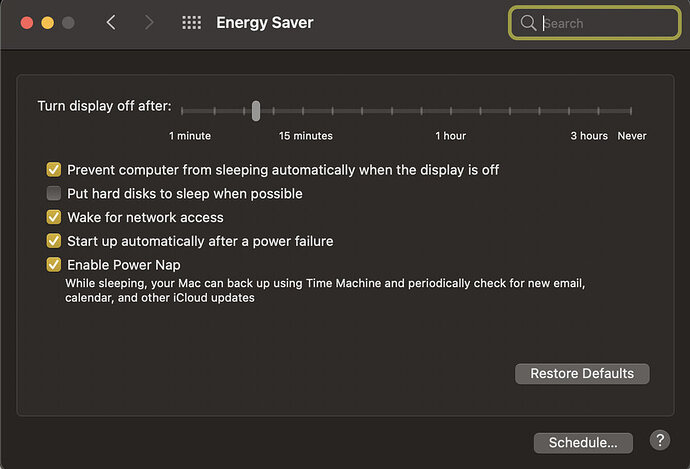

I found a mac user’s blog that might help.
These are Energy Saver settings I use without issue.
As for Reset SMC, it’s very simple process but don’t forget to dismount your Storage volumes and dis conconnect. To add, on my main storage USB Volume I use a Thunderbolt to USB3 cable as Mac’s have had intermittent issues with USB External Volumes over time. (Just a thought if not using that port).
