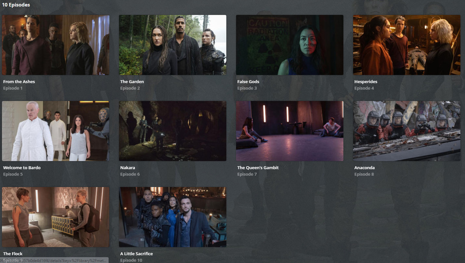

I misread your new response and just did a ‘Refresh All Mediadata’ my Series folder and guess what: The missing episode is suddenly visible. Even an apisode that is just downloaded.
See underneath screenshot:
