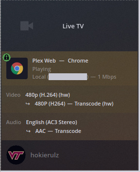

If it is using the GPU to transcode you shouldn’t be seeing much CPU utilization (my Plex CPU use is negligible when hardware transcoding.) Have you looked at the Plex dashboard in Plex Web with Show Details selected? It should show you if it is transcoding, and have a (hw) after if it is using hardware transcoding. For example:
This example is low res, but higher res hardware transcoding barely shows any CPU usage for me.
If you can verify that Plex is hardware transcoding, then when you look at win task manager, what process is showing the high CPU usage? Also, are you using subtitles?

You can see from your screenshot above, the (hw) indicates the gpu doing the encoding work. (although encoding x264 is relatively easy for most cpu)
Unfortunately decoding HEVC (ie 4k) is extremely difficult, which is why your cpu is getting hit so hard.
