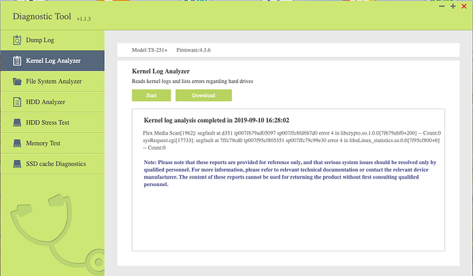

My QNAP NAS appears to have an error, which I do not know what is impacted or how to correct. Does anyone know how to approach and correct? The following is the Kernel Error List/Log.
QNAP Diagnostics - Kernel Log Analyzer with results: Plex Media Scan[1962]: segfault at d351 ip007f679ad05097 sp007ffc8fd6b7d0 error 4 in libcrypto.so.1.0.0[7f679abf0+200] – Count:0
sysRequest.cgi[17733]: segfault at 7ffc79cd0 ip007f95cf805351 sp007ffc79c99e30 error 4 in libuLinux_statistics.so.0.0[7f95cf800+0] – Count:0

I’ve restarted my NAS many times and ran diagnostics, which always displays the same message. It does not seem to matter if run immediately after restart or hours later. I don’t know what is impacted or how to clear. This seems static as if processes touch some issue regarding PLEX. I’ve stopped Plex and the error continues. Any ideas?
