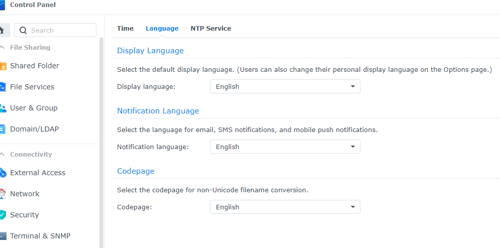

Would you please confirm your Synology’s region settings are setup ?

Synology Regional setting are standard English:
