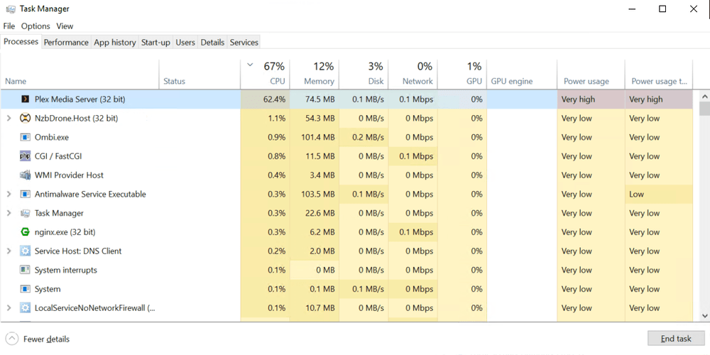

Ok now its building up to 70% CPU usage! I can hear my PC fans so load.

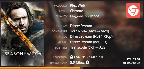

I’ve narrowed the problem to when plex does a direct stream instead of direct play, and that’s only locally. I’m using the PC to play a movie, using logitech headset and when playing with stereo audio it direct plays everything.
when changing the audio to aac 5.1 (or even ac3 5.1) it shows transcoding to direct stream.
However, I’m seeing plex media server.exe racking up CPU, and it never stops! It averages at around 40% until I close my movie.
If I change quality to lower (and thats all playing locally on a PC), transcoding kicks in, and it only uses about 8% to 10% (using hardware accelerated encoding on).
I tested this also remotely, same behavior! This only happens with audio being chosen 5.1 and being direct stream.

When changing from direct play to direct stream because of audio changing from stereo (aac) to 5.1, if subtitle is none (no subtitle playing), plex media server.exe would go up for a split second and come down, hitting max of 10% cpu usage and down to 0.5% roughly stabilizing, all less than a second.
Once I choose a subtitle when the media is direct streaming with 5.1 audio, plex media server.exe would spike up to 20% and stays around there.

This is (as of testing it manually) caused by when subtitles are converting from SRT to ASS only.
with ASS, the “Plex Media Server” (not transcoder), gets stuck on cpu, hovering around 20% initially.
This will then rack up to 75% (max I saw it because I manually shut down the stream) if left for more than 20mins.
This is only happening if it was “direct streaming”, not direct play or transcoding.

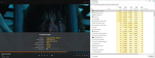

This is playing with Audio stereo with an SRT subtitle (UTF-8) using Tautulli
This is from task manager, Plex Media Server would spike up to 14% then down to almost 0% within a second or two to stabilize.
And these two pics are shown with Audio being 5.1, PMS would quickly reach around 20%, then longer I wait, it will slowly rise.

Playing a Movie that has AC3 Audio and SRT converted to ASS by PMS
So as this is new update/install, no memory leak. First time playing the movie after install/update
(SRT is converted to ASS) Using Plex Web App.
Same movie watching it, now I try to rewind it 3x back using Plex Web App, using keyboard arrows.
Taking it further another 3x rewind (using keyboard back arrow, not mouse).
It feels like PMS is stuck on something, everytime I try to rewind more and more, it stacks up. So I tried to rewind 6x back, for the sake of testing, here’s the result:
I can also go back until PMS CPU hits around 70%, that’s the max I ever saw it hit, anymore rewinding would rarely go back to stable though, back to normalizing.
