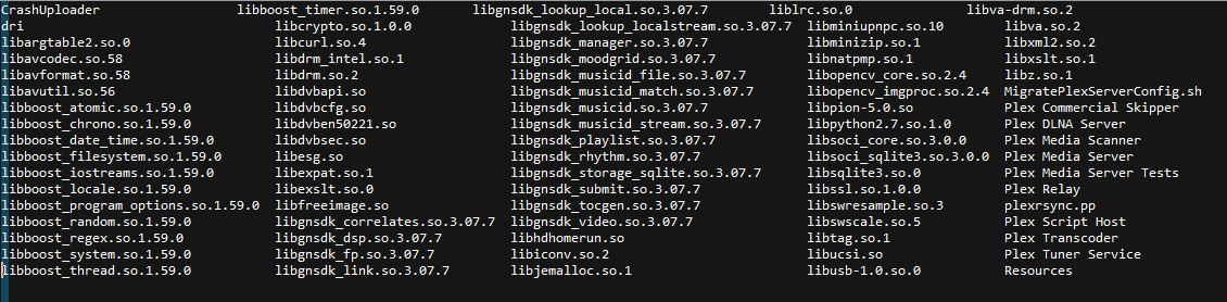

/usr/lib/plexmediaserver/Plex Media Server: error while loading shared libraries: libboost_atomic.so.1.59.0: cannot open shared object file: No such file or directory
Then what are the contents of /usr/lib/plexmediaserver
Something went sideways with your installation. Let’s find out what did.

Do you have /usr/lib/plexmediaserver
on a non-OS drive? (the exec
bit is needed)
No, is is on the only drive on the system.
[root@centos plexmediaserver]# find / -name “Plex Media Server”
