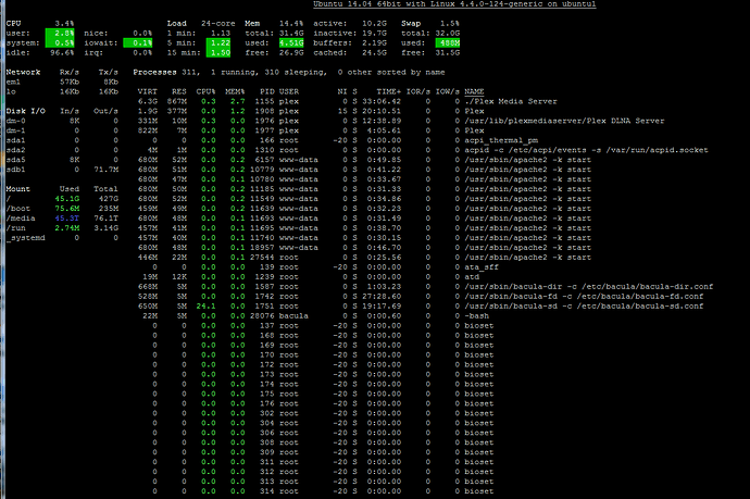

With 4.5 full cores in use, demonstrating PMS is multi-threaded, You’ve got something serious going on however to find out what’s actually happening will require DEBUG (VERBOSE turned off) log files
The best I can suggest is verify logging settings the restart it.
If, without doing anything, it is sitting at 450% (4.5 cores), there’s a major issue which needs to be solved first.

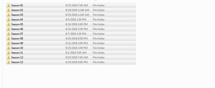

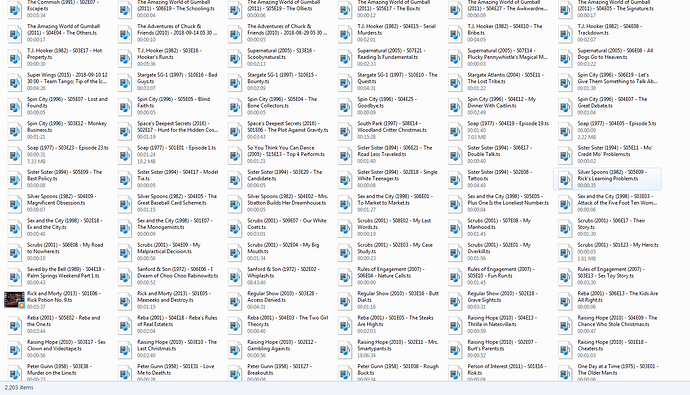

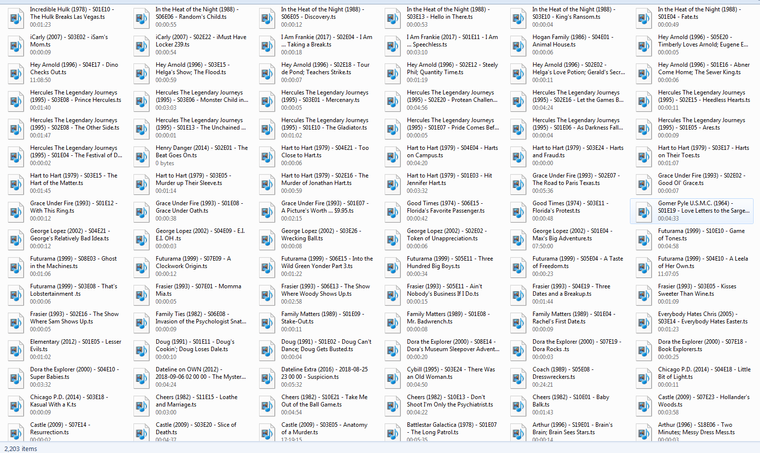

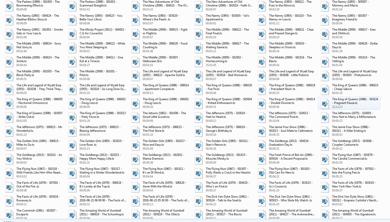

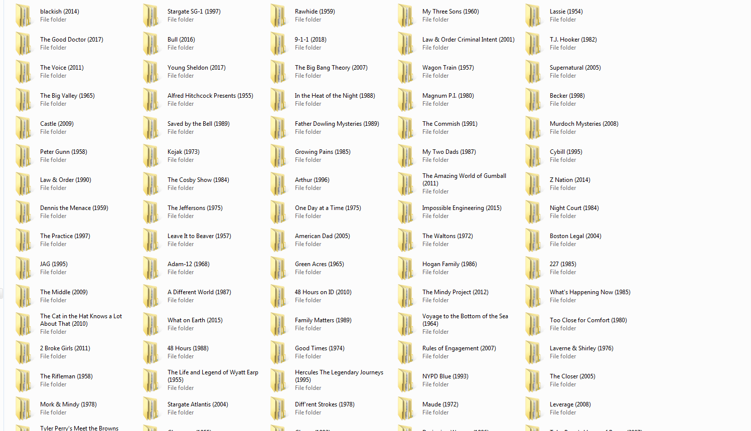

Chuck this issue still happening and also others, all screens freezing and taking for ever to load and update even home page. also scanned drive and have 558 files that are less then 200k where videos are recording but not completing or not full length. since the last time i scanned the files last month.
Do you have all those files in one directory?
You do realize that’s now how they should be organized?
500 files in one chunk is going to be slow even on a big honking i7 Linux machine with an SSD.

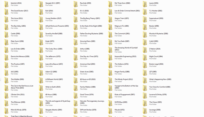

What you have now is an amorphous pile of ‘stuff’.
yes i realize that. this was just a quick search of the entire raid for any file smaller then 200k otherwise there setup according to plex guide lines i do a nightly scan, empty trash, clean bundles, optimize db. the database is currently at 55.5 mb in size. but still all the areas running sluggish and slow. not sure if its the sheere volume thats going through it or something else. and still creating copies on some shows and files

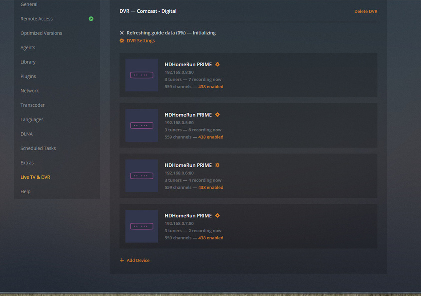

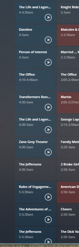

ok lets start with the guide issue and the crash. after restarting the service it took the guide 1 hour to update. attached is the logs since the service restart the posts before have for the last several days including prior to service restart after crash. Plex Media (13.2 MB) @ChuckPa @sa2000 thanks for all your help and time. hopefully we can get to the bottom of it and iron and smooth things out. let me know if you need additional info went to recordings and its timing out refreshing page and server looks like this,

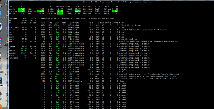

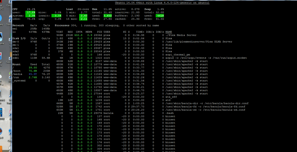

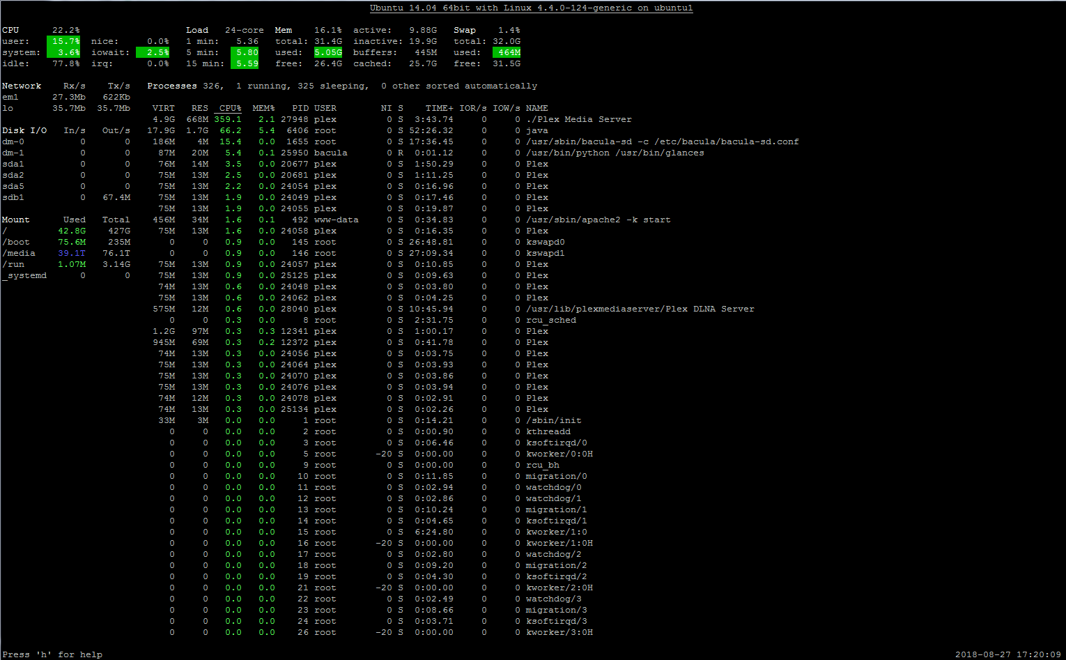

The attached screenshot above shows a 21% CPU utilization across 4 processors
Examining it further shows PMS and it’s support processes.
The logs show, almost exclusively, LiveTV session transcodes and recording.
The transcoding accounts for the CPU utilization.
Database operations appear normal.
I can not speak to DVR operations of the grab but this is a “Capture network packets & write to disk” loop requiring little CPU.
The Xeon in use has 7932 Passmarks.
https://www.cpubenchmark.net/cpu.php?cpu=Intel+Xeon+X5670+%40+2.93GHz&id=1307
This is slightly less than a 5 year old i7-3740qm (my desktop system).
This level of CPU loading is to be expected with an older CPU.
I have been looking at the logs to see the guide refresh activities
There were two refreshes - one completed in 8 minutes but deferred some of the updates to later background activities that would kick in later - it is called incremental EPG refresh
The second refresh which I presume you instigated at 14:58 took 54 minutes to complete.
Sep 28, 2018 15:49:03.824 [0x7f6490bfe700] DEBUG - EPG[onconnect]: Step 56/56 (2018-10-12T12:00Z) (network: 584.8 sec, database: 2466.9 sec total: 3048.4 sec)
A big factor is the number of channels. If you have 500 channels, for example, that time is about right
