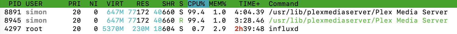

Same issue.
Running the most recent official Docker Image and CPU load has been on 100% for a long time. I just tested it with an empty library - same thing.
I started the container with docker run -d --restart=always --name=plex --network=host -v /opt/plex/config:/config plexinc/pms-docker where /opt/plex/config was an empty folder.
