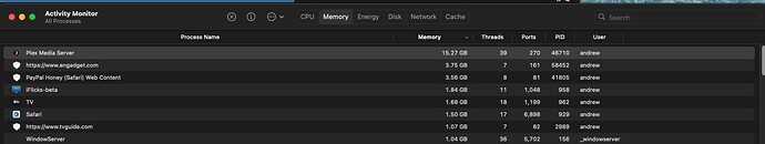

Hi, I’m wondering why Plex server running on Mac Studio with macOS 14.1.2 starts consuming so much memory after a while.
Here is a pic after Plex has been running for a few days.

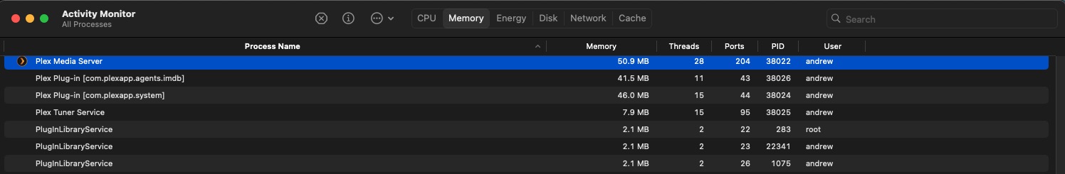

If I quit Plex and re-launch it the memory usage goes right down to this:
Is there a memory leak or is this behaviour considered normal?
