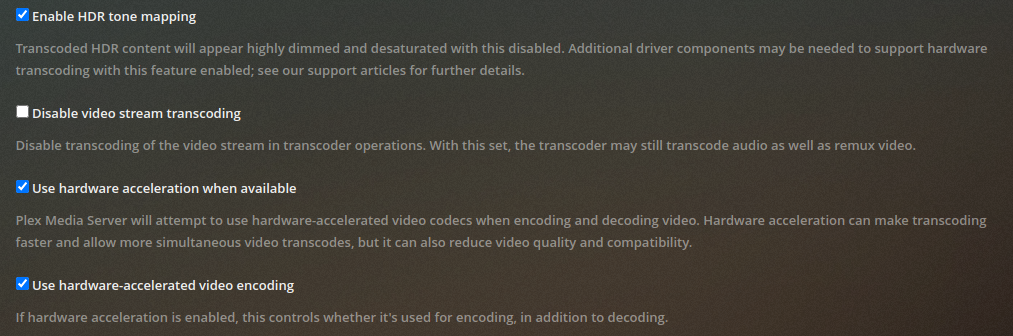

  1. Please report status of Settings - Server - Transcoder
    a. HW transcoding settings
    b. HEVC HDR settings.

  1. Here are my HW Transcoding settings:
