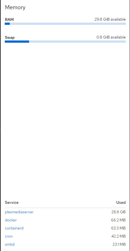

So I’m using dev/shm for Plex RAM transcoding and it’s filling up my 32GB available RAM. Just now, I saw the folder reaching 28GB. I thought it’s supposed to be just up to 50% of RAM?

Yes, sorry, that was a typo. This is exactly what I used: /dev/shm/transcoding and this is what I was getting in cockpit:
When I deleted that folder, the plexmediaserver RAM usage went down to 137MB.

I don’t get why it just says 454MB there but it says around 8GB in Cockpit for the plexmediaserver service. I tried not using /dev/shm and have Plex use the default tempdr in my custom config:
# Change TMP directory for transcoder
Environment="TMPDIR=/home/plex/Transcode"
And when I check Cockpit, I see that it still uses a significant amount of RAM (4GB now). Does that mean Plex uses RAM for transcoding regardless of the transcoder temp directory configured?

I’m honestly not sure because I’m basing my claims off of Cockpit. Are you familiar with Cockpit? If you see my post above, it says that plexmediaserver has 28.8GB used but then the bar graphs above show that I still have 29.8GB available physical RAM.

I see. I guess I’m just trying to understand what the plexmediaserver usage means? Right, now I’m transcoding three different 4K streams to 720p just to simulate and this is what I get in Cockpit:
And for /dev/shm:
root@nuc:~# du -sh /dev/shm/*
4.0K    /dev/shm/9334581e-7251-4ef7-a8ec-5bfe8e89ff68
1.5G    /dev/shm/transcoding
So that’s just 1.5G worth of space in /dev/shm but why does it say 26.1GB “used” in Cockpit? And 24.5G available. The numbers do not add up unless I’m missing something?

Where do you find that detailed display in Cockpit?
The closest I can get is this:
which matches this:
[chuck@lizum ~.2004]$ free -m
              total        used        free      shared  buff/cache   available
Mem:          64232       12271        6445         291       45515       50972
Swap:         61034           3       61031
[chuck@lizum ~.2005]$
System → Overview → Usage → Memory
Which version do you have? I don’t see the chart you posted on my Cockpit. I’m using 266.
