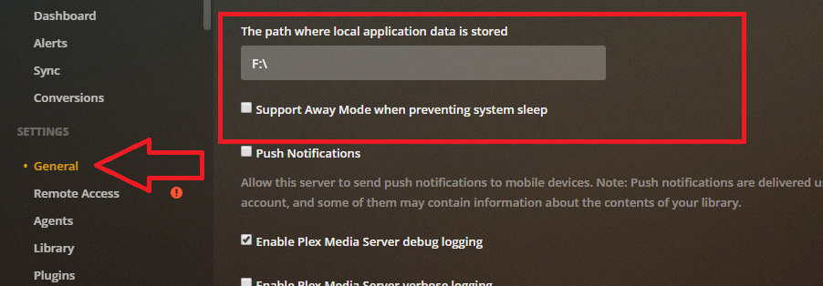

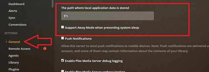

  • Go back to your initial setup. Move the PMS appdata folder to a non boot drive location then change the setting to find this folder.
  • Copy the PMS registry and make a backup.
  • boot to other drive
  • install PMS, do not start it up yet
  • apply backup of PMS registry to this registry
  • start PMS
Applying the registry should have also change the appdata location, but check it just in case.
Your account should show only 1 server. But keep in mind that some PMS settings are saved in the registry so if you make changes, you’ll need to redo that setting in the other boot drive.
