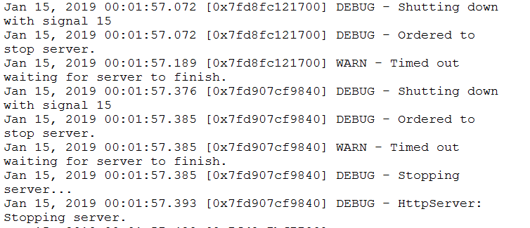

this is from your Plex Media Server.1.log
signal 15 is probably a result of your crontab entries
Take out your crontab entries and let it fail again and collect logs next time and repost so we can see what is causing the actual failure.
