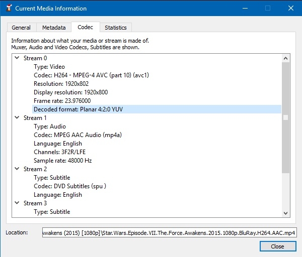

Can anyone please enlighten me why this H264 encoded MPEG-4 AVC will not direct play to the Vizio smart tv? Audio seems to directly stream fine, and it’ll play without issue from a usb flash drive in the side of the television. What or where am i doing/going wrong??
Video Codec: H264 - MPEG-4 AVC (part 10) (avc1)
Resolution: 1920x802
Frame rate: 23,976000
Decoded format: Planar 4:2:0 YUV
Here’s screenshots:
