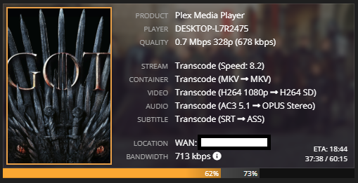

Most of my friends use my server with no issue, with the exception of 1. No matter how he plays the content (mainly uses the Windows Plex App), his stream ignores my set transcode buffer (which is set to 60 seconds) and it occasionally restarts the transcoding process - I can see the buffered portion disappear and start to build up again. This is causing consistently high CPU usage and causes issues with other streams there are attempting to be played.
This issue occurs regardless of what they watch and works as expected for others.

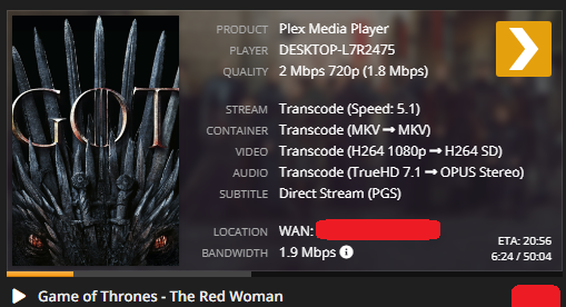

Attached picture is an example. Listed is his buffer and another user, while they are watching different episodes and one is slightly longer than the other, the buffer definitely extends beyond the set 60s.

The bandwidth for the user in question is shown in the picture, at about 1Mbps, with another user streaming at 3.9Mbps - the former is transcoding up to 47% of the file (and it’d increase continually and occasionally reset) while the latter user is as expected, transcoding buffered by max 60 seconds.

Thank you for the reply! I waited for the user to start another episode however when they did, they exceeded the 1Mbps cap you advised of but showed the same issues that led me to create the topic - I have attached another screen cap of their stream stats.

Edit: I noticed that in two different episodes, the transcoding goes up to 73% (the image attached had its buffer increasing until it hit that 73%), so my CPU gets hit hard at the beginning of the episode until it hits that 73%. I’m not quite sure at this point when it’ll kick in again but it seems odd the behaviour has reflected over 3 episodes. I have no idea why this one consistently ignore my 60s buffer limit.
Edit 2: Somewhere around 60-70% through the video, transcoding kicked in and finished up to 100% of the video.
