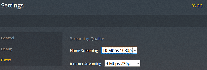

- About PlexWeb, I suspect that you are also limiting local quality to 10Mbps, such as, otherwise PMS thinks that your PlexWeb is remotely connected and transcodes because of it
It’s always better to play without transcoding. The quality will be preserved. Transcoding always impacts quality, but in several cases it’s a must. If you really need transcoding probably you should try to specify a target quality for local devices less than 10Mbps. It will lower the quality, yes, but maybe your CPU will be able to handle it, because target bitrate is one of the most influencing parameters on transcoding CPU usage.
Having tested it a bit, setting the Roku to ‘original’ and handling subs locally seems to have largely fixed the issue there.
The web player has ‘Home streaming’ set to ‘Original’ and seems OK unless I turn subtitles on. Perhaps a CPU upgrade is the only solution to that.
