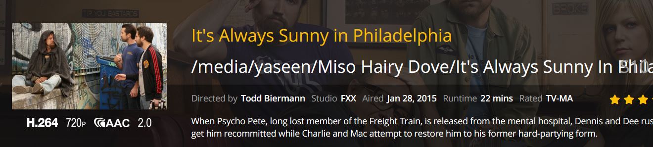

Well, this is strange. For some reason Plex added "/media/yaseen/Miso Hairy Dove/" to almost a full season. I tried to refresh the metadata but it still says this. Maybe Linux isn't my thing, I may need to stick with what I have all my certifications in... Microsoft. hahaha
It is always best to go with what you know best
