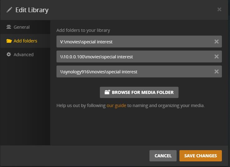

I turned off “empty trash automatically” and scanned. This is what I see
This is the library with all three types of mappings in the image above.
The log entry from this scan below. It looks like Plex only used the first folder in the library

What happens if you remove the drive letter V and the hostname reference, and leave in only the one with the IP address?

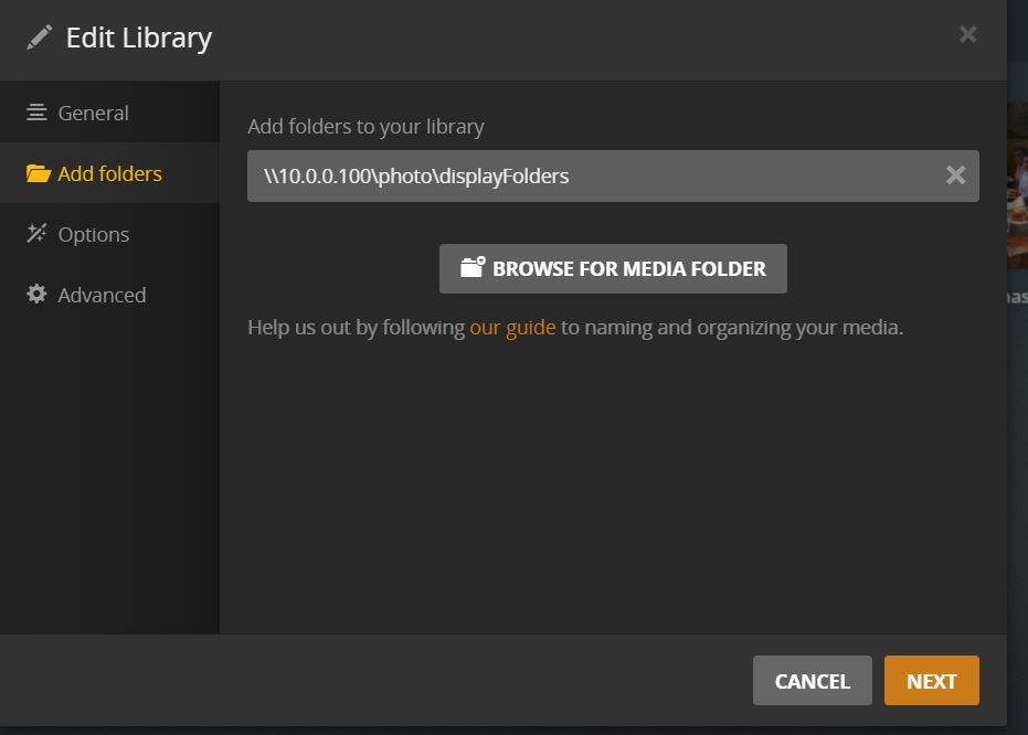

I removed the mapping from my folder and replaced it with \\ip address\directory, re-scanned the library and it still can’t find the files.
The odd thing is that the ONLY library that works is my photo library, it is NOT configured with a drive mapping.
