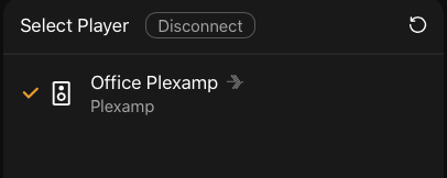

Also ensure you’ve selected you headless Plexamp device as the player:
If it’s already selected, it may help to click Disconnect and then reselect it. I find that I sometimes need to do that after an upgrade.
yeah disconnecting and reconnecting worked - headjack works fine now
