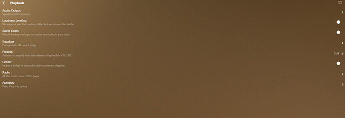

Is there any way to get “bit perfect” out of the Plexamp, as I prefer Plexamp’s features to the main Plex App? Are there any settings in Plexamp, which I am missing to enable bit perfect? Audio output is direct to the DAC, loudness is off, fades off, equalizer off, preamp set at 0, no limiter imposed…
Music Quality is also set to MAXIMUM.

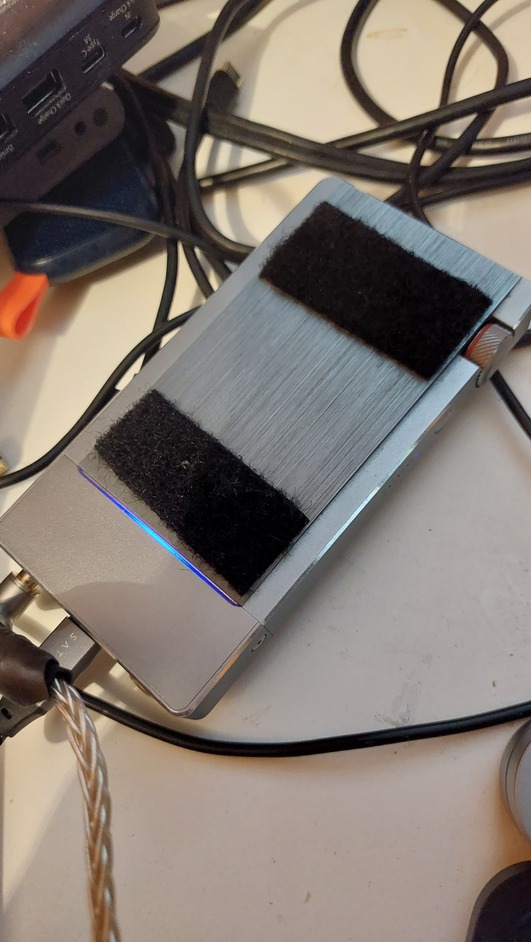

PS see here…
Working fine in Plex app - yellow indicates hires 24/96 OK!
Not working fine here - Blue indicates 16/44 - same file playing in Plexamp

Thanks for reply, but either Plexamp is outputting the signal as it’s receiving it from the server, or it’s not? My point is, if it’s not outputting 24/96 bit perfect but is downsampling to redbook cd format to a connected DAC then surely fudging in settings to force the dac to upsample a 16bit 44k signal is not optimal?? My question remains… does Plexamp downsample whatever hd signal it’s fed or can it send a 24/96 signal (for example) to any suitable USB DAC?
Plex vanilla app is fine - HD in HD out
Plexamp seems to be HD in Redbook out,
