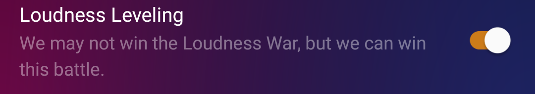

Plexamp could win the war of loudness by also using Tracks Normalisation? (as Spotify does)
I was reading this article: https://audioxpress.com/news/tidal-implements-album-loudness-normalization-and-activates-it-by-default-for-mobile-players shared by Elan in another thread.
It was really interesting and help me learn a few things but the main information was the fact that Tidal (and plex ?) uses Albums Normalisation over Tracks Normalisation. As it is for sure Album Normalisation seems a good choice, but it would be great to add the option to toogle Tracks Normalisation.
I think that for playlists users, tracks radio users, radio users DJ Guest users, well, Plexamp users, and so on, it could be a great option to add it to plex.
I for sure will use it while listening to my playlist because very often Album Normalisation doesn’t feet and fill the volume gaps between a song and another.
I think that Plexamp should use it like Spotify does :
That seems to be wise and would be the best way to add it.
