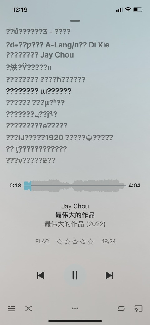

Plexamp lyrics display garbled code ~
It is not sure whether it is the problem of text support or the problem of file format coding. Now a lot of music lyrics are garbled.
Does anyone know how to solve this difficulty?

Do the lyrics look the same when you look at them in the web app?
Is the .lrc file encoded with UTF-8?
Hello, thank you for your reply. I think the problem should be the encoding format.
I share a document here for your convenience.
Is ANSI format.
It seems that many lyrics are using this format now. If it is possible, I hope it can be supported in the future. thank you. :two_hearts:
Unfortunately, you got it backwards.
ANSI is an old format, it should not be used anymore.
All subtitle and lyrics files for use with Plex should be encoded in UTF-8.

Thank you so much. It succeeded. I didn’t know it would be an old file format.
But I think many old songs use this format. At least I have hundreds of songs like this.:rofl:
