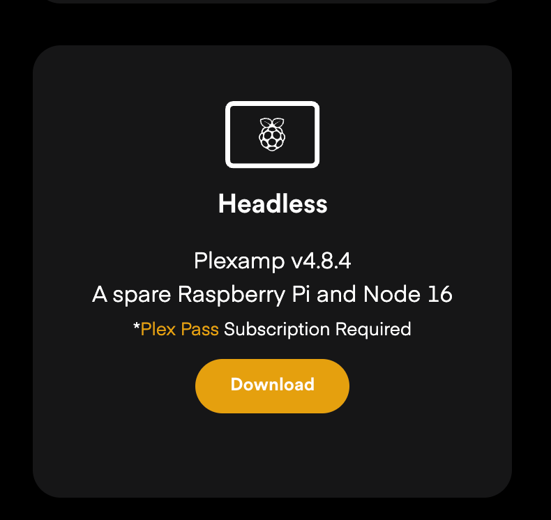

Hi there - I have plex install on my synology NAS and mainly use for films and TV, and occassionally I use for music. Generally this is easy as I only play on my PC whilst working. However can I install plex to run on a raspberry pi 4, not the server, but as a streamer/endpoint? Ideally then I would control plex on a tablet/phone, but play from the pi (which would be linked to my main stereo DAC).

I think this is what you are looking for:
https://www.plex.tv/plexamp/#downloads
Thanks @pjv - is that to act as a ‘streamer’ for the pi or the ‘server’? I could not tell for sure.
Assuming its the streamer, could I then control it via the app on tablet/phone?
It says “Plexamp”. Plexamp is a Plex client, not the Plex server.
Yes, the same way you can control other Plex clients in your local network. https://support.plex.tv/articles/categories/features/casting-flinging-remote-control/
