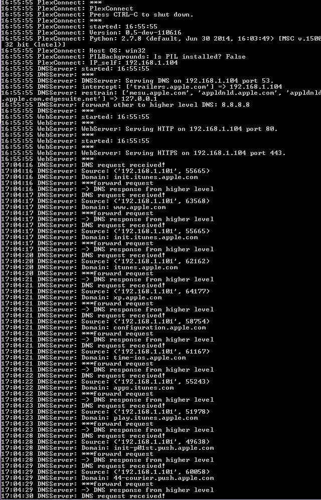

Issue - ATV3 doing muliple things except playing files. I either get plexconnect cannot location library (or similar) or i get the librarys and the thumbnails are all grey and they won’t play/get an error.
I can connect to the PMS through my samsung TV (not the app, just straight folder searches etc). I noticed plexconnect had some action when this was working which is below.
Any ideas or have i missed any info required?
