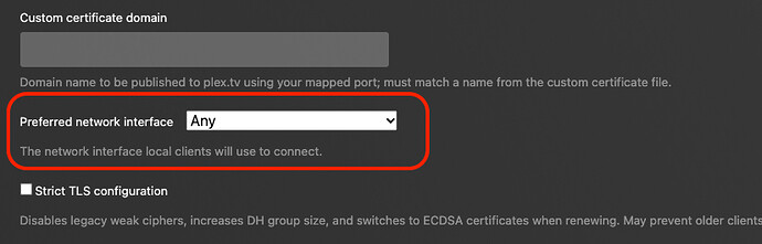

I’ve not done it recently to test, but it’s possible that you can instead specify eth1 in PMS.
Change the Any in Settings → Network → Show Advanced → eth1
If that doesn’t work, switch your interfaces on the QNAP so that PMS gets to use eth0.

I already have this set to eth1 (172 range) and yet the server continues to refer to itself by the 10 range (for example, in remote access Plex believes it’s private IP is still 10.0.0.x).
Unfortunately, as of QTS 5.0 it seems that virtual adapters no longer show up at all in the Networking control panel, even though it’s obviously installed as device eth1.

If that’s your contention, then what is the purpose of the “Preferred network interface” setting?
I have 172.28.x.x set as preferred. According to the decription of this setting, that is the network interface that local clients “will use to connect”. That is the “right” IP, is it not?

To add to what @pshanew said,
“Preferred network adapter”
  1. Is the one PMS PREFERS to listen to.
  2. PMS has NO control over which adapter the traffic is sent on.
