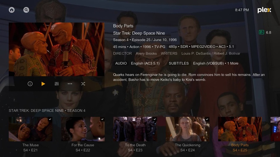

  1. I have show ratings on for both TV and Movies. But on newest beta the TMDB badge has disappeared from the episode screen even with all the ratings turned on:
  2. VOBSUBs aren’t showing up for me in latest beta. Worked once I downgraded back to beta 4.6
Your screenshot shows a TMDB badge, or am I missing something?
What does that mean? Where? And did you check the forced subtitle fix changes in 6.7?
I’ll need logs via DM (DEBUG enabled)

The screenshot is from the old version that works. The newest beta doesn’t have it.
The selected sub isn’t showing up in playback. The same selected sub shows up in prior versions.
For me it does. Weird.
Edit: Wait, that’s an unwatched episode. What are your no TV Spoilers settings?
So the subtitle is correctly selected but the actual content doesn’t show? Do you have logs for me?
