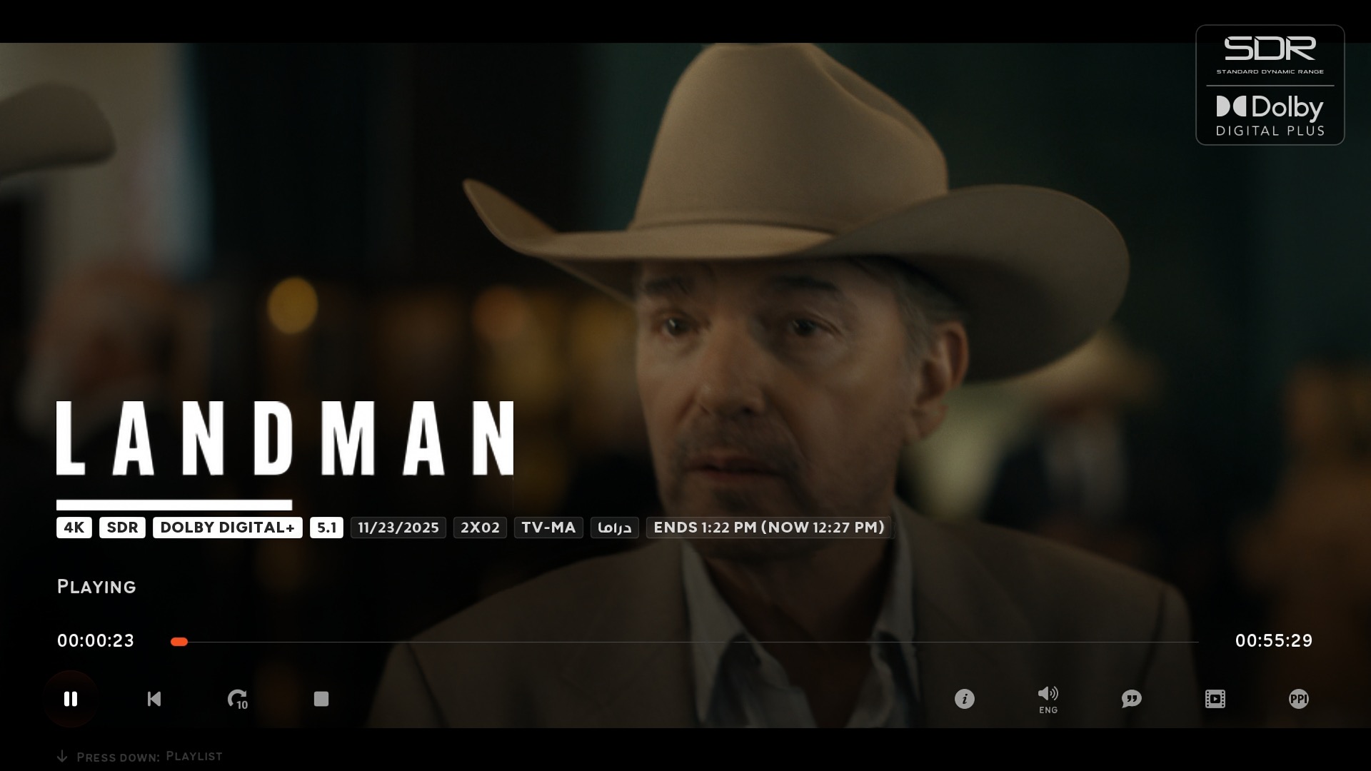

Is it possible to add an option to use the Kodi player OSD? The Kodi player OSD offers a more modern and appealing interface. At the moment, I can only access it by pressing “play,” then immediately pressing “back,” which opens the video in the Kodi player and supports background playback. Please consider reviewing the AF2 skin’s player OSD, as its design is excellent. Additionally, users can change the player OSD by selecting different skins.

PM4K / PlexMod for Kodi (18, 19, 20, 21, 22+) - #5312 by alrufa
This is nice!
I’m trying to understand what you explained here…are you saying that you have the AF2 skin installed (along with PM4K) and are able to get to the AF2 player (in a roundabout way?)
You’re right , and this method doesn’t apply only to the AF2 skin; it works with all Kodi skins. The reason we prefer it is that it allows easier customization and provides quick access to the Kodi subtitles addon.
